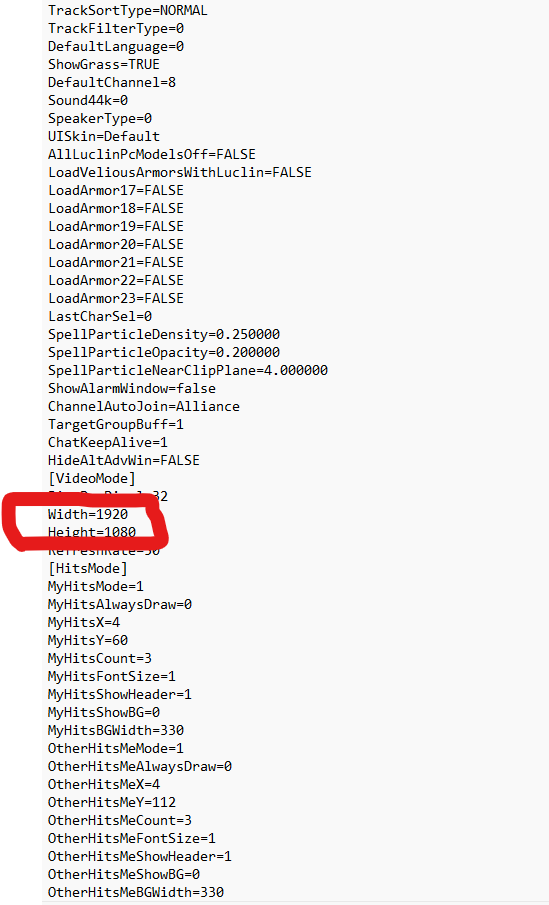

    Full screen - you do this by setting WindowedMode=FALSE (this makes the title bar and stuff go away so it's a borderless window) and you set your Width/Height to your desktop resolution. If you're playing at something larger than 1080p the UI elements will probably be too small in the same way that the Stone UI is small. I made a mod for 4k that doubles the size of all the UI stuff.

    Thanks for the detailed response. One thing, though - there is no height or width setting in my eqclient.ini. Am I looking in the wrong file?

    That is so odd. I swear I searched for them, but there they are?! I guess I spelled "height" wrong.
